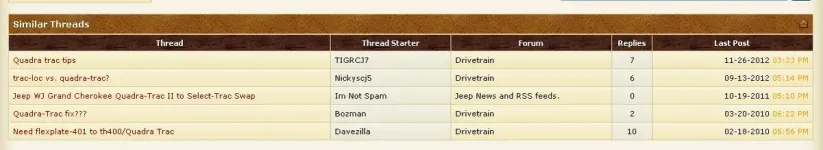

another helpful tip:
If you get to a thhread (from searching or reading one) that is close to what you are looking for, or you still want more information, look at the very bottom of the page (scroll down) you will see a box that says "Similar threads"
attachment.php
Click one of these to go to another thread... Has proven helpful to me in the past.
