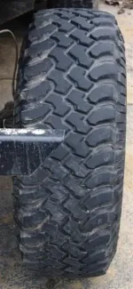

my 31x10.50s were rubbing in places that a lift wouldn't have helped (front on the springs when turned, rear on the inner tub walls under flex). i put 2" spacers on mine and i'm a fan. after about 3 inches of lift, and i'd have to break something in a big way before they'll rub now. (that just means i need bigger tires, right? :chug:)
you can feel LOTS of added stability in turns, which makes a big difference if your rig, like mine, doesn't have sway bars. that stability is also nice on the trail.
