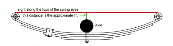

To measure the spring, pull a string between the center of both spring eyes and measure the distance between the string and the lowest point of the spring arch. Naturally, you have to do this with the spring unloaded, not with the weight of the Jeep on it.
OEM springs:
If you have 4 leaves on the front, it should measure 5 3/4"
If you have 7 leaves on the front, it should measure 6"
On the rear, 4 leaves should be 4 3/8", 5 leaves should be 5 1/8"
I found this picture, but have never tried measuring this way, so take it for what it is worth.
I think this a good reference point, it will give you a starting point.
