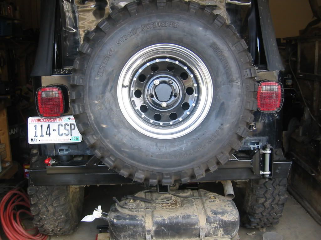

Seeing that we cant get the stuff at a reasonable price here, I used the same bearings that is used on the Jeeps front wheel bearings. Its also a taper bearing and "stole" the concept of the net. If you can turn steel then this is another option to look at.
The bearing number is LM501349 and I used 2 as in the pics.
