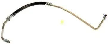

Hello, I'm swapping in A 4.3 v6 engine and power steering reservoir in my 76 CJ7 Jeep that has the saginaw power steering but was told that it will require a new specially made power steering line that will go into the power steering on my vehicle to the reservoir on the engine.
Could someone lead me in the right direction on where to get this modified or if they make these hoses aftermarket and ready to install???

What I did on our 79 CJ7 was to buy the OEM hose. This hose fit the pump, but not the gear box. After trying to find all kinds of adapters with no success, I just went to a local auto parts store and found that a generic brake line with the same diameter hose fit the gear box perfectly.I cut the end off the OEM hose on the gear box end, and cut the nut off the generic brake line. Put the nut on the OEM hose, and flared the tube. Instant custom hose! :D

Super! Looks like you are about 30 minutes of work from adapting your own hose.:) If the metal part of the GM hose is 3/8" like the Jeep hose is, what you will need is 2 flare nuts for 3/8" brake line and a coupler to splice 3/8" brake line. Yes, you must retain the rubber part of the hose. If you only use steel line it will break due to the engine torque.
Cut the metal part of the Jeep hose leaving how ever much you need, do the same with the GM hose. Put the 3/8" brake flare nuts on each hose and flare them. Connect the 2 tubes with the coupler, and your hose is ready.:D

That will work for the return line = no pressure. Take your pressure side tubing to a hydraulic shop and they will do it for cheap. Should be cheap and easy. Pressurized hydraulic lines are crimped in a special way.

Just saw this. My hose looks just like a CJ hose. As I wrote above (and others) You need to have the pressure side done at a hydraulic shop. ...that is unless you have the proper hydraulic line crimp machine.

Our problem was that the hose fit the pump, but not the gear box. All I had to do was to cut the nut off the end that goes into the gear box. Then put on a new nut, which happens to be the same as a 3/8" brake tube nut, and re-flare the tube. You could do the same thing at the pump instead of the gear box if you have the room, but it is unlikely that a 3/8 brake nut will fit the GM pump. You would have to do some looking to find the right nut. Again, I don't know what diameter the GM tube is. You may have to do some mix and match at the local parts store if it is metric.
This is an OEM Jeep hose. The blue line is where I made my cut, then put on the new nut and re-flared the tube. Do the same thing with your GM hose.

Hmmm. Unfortunately I don't have one. :( So will have to go to a shop.. (darn it) Thanks for the help. :chug:.
