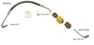

I think this should make things crystal clear if you want to adapt your 2 hoses to fit instead of having a new custom one made up.
I will address this using the GM hose, though you can just as easily use the Jeep hose. Only difference would be that the splice would be made on the other end using the Jeep hose rather than what I have illustrated here.

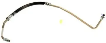

Here is a stock photo of what I think your GM hose looks like. I am not sure which end is pump, and which is gear box, so if I labeled it wrong, just cut the opposite end.
Here is what your Jeep hose should look like.
Here is the order of assembly using the GM hose with it's original fitting to go to the pump, and the lower end of the Jeep hose to go to the gear box.
The fittings to make the splice between the 2 hoses are standard 3/8" brake fittings available at any auto parts store. The flares are standard inverted flares as shown on the left of your 2 pictures.
The part numbers from Advance Auto are: BLU-6C for the union and
321416.1 for the nuts. This is based on the assumption that you have 3/8" metal tubes the same as my Jeep has. If for some reason they are different than 3/8, get the appropriate size for your metal tubes.
Hope this clears things up for you! :D
