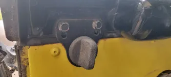

You can adjust the window here on both sides. When I went from original soft doors to 1/2 steel doors and soft windows it took me 4 or 5 times taking the top partly off and fractionally adjusting those bolts on each side. Now I can use both original soft doors or 1/2 soft windows with half steel doors from a YJ. I willlook and see if I can find the correct vendor I have been hearing about who makes a pretty good seal. If you look closely you can see where the bolts were for a long time before getting adjusted 841C300C-38E4-479A-B757-C323252B0C8E.jpeg

No it’s on hinges. By loosening then pushing the top of the frame forward it gave me more room for the frame of the window which is what I needed in that area. Sounds like you need to loosen and pull back at the top of the windshield. I would need to look probably at yours before I adjusted just to see what you have going on. You may really need a new gasket and not need to adjust it. Or if you get a new gasket, it may then need adjusting.
Have you taken the 2 big screw knobs off and pushed the windshield forward and laid it on the hood and inspected the gasket yet to see how pliable it is ?
I did several years ago but I need to do it again. I did scratch my fingernail on that end of the gasket showing and it was crumbly and hard.
here are the adjustment knobs, what I did last time I put the top on I used ratchet straps to pull the top back with these loosened up and then tightened they up and finished putting the top on. So it looks like that rubber must be rock hard?
