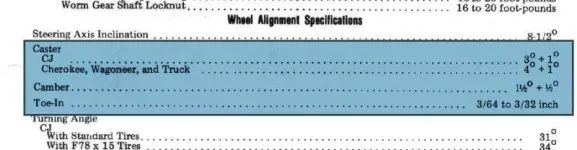

You don't say what year but the newer Jeeps (80's) caster is 5-7 degrees pos.
I don't have access to a 75 tsm but in the 76 tsm is says for a CJ5 the caster should be 3 degrees + 1 degree. Now I assume that means 3 deg. plus or minus 1 degree.
Jeep® 1976 TSM online
It didn't load correctly for me so I had to open it in Adobe, but it gave me the choice to open it in another program.
Looks like it's the same:
Source: Online Jeep Service, Repair and Maintenance Manuals
Page 53 of http://www.toeksplace.com/jeep/amc/11_Steering.pdf
