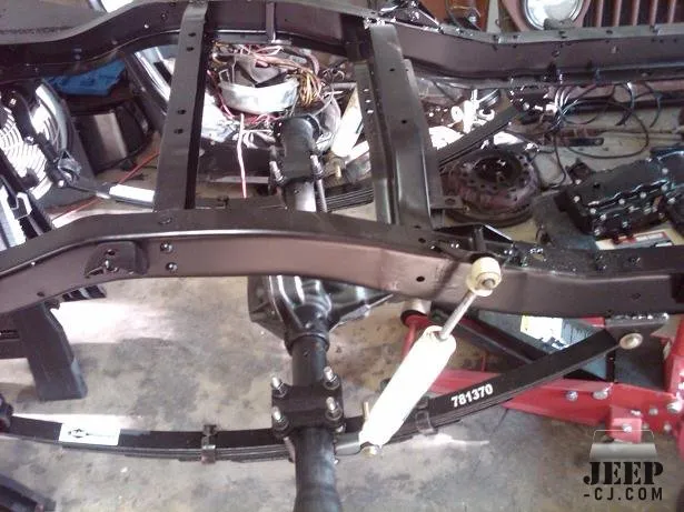

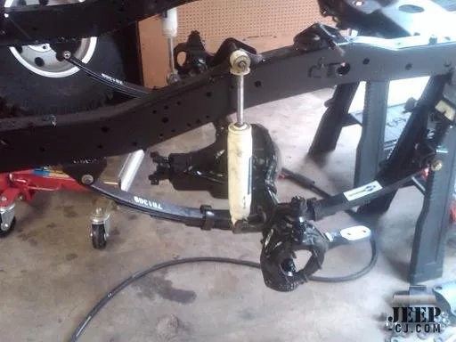

Hey, I’ve got a question for you. Have you flipped U-bolts on a normal SUA setup…
I did on an old YJ I had, but don't have any pictures of that Jeep. I like the u-bolt eliminator kits, that completely get rid of u-bolts.
A little more progress! I fitted my rear driveshaft with a conversion u-joint. Won't have to deal with a conversion joint with my new Tom Woods driveshaft, but wanted to get this spare driveline ready to use. Also, got one out of four shock hoops done. Building them stout, and will tie them into my new roll cage, so that if I decide to four link and coil-over the Jeep later, it will be ready to run coilovers. 20230119_140451.webp 20230119_131353.webp 20230119_140443.webp
Guess I’m behind in technology. What are they ?
I need to stay focused on my original intent of this Jeep. I keep staring at the one tons and LS engine in my garage, and keep thinking about how cool the CJ7 would be. But, it'll be a fun rig the way that it is being built. Going to take it to a lot of cool trails this year!
Great. Thanks for the link. No U-bolts, that got me thinking until I saw the image.
And from what I can tell, the snubber doesn’t need relocation.
The website says it’s intended for SOA, not SUA. What do you think…
