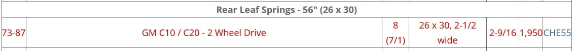

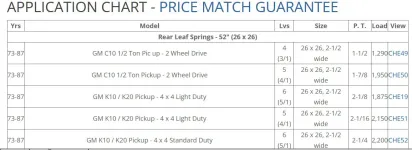

Since the YJ rear leaf is approx 43" eye to eye(using YJ frame and leafs) what about an older GM set of leafs, either 52" or 56" regardless of how many leafs and disassemble them to either a 5 or 6 leaf setup to get the correct ride height, extend rear of frame to accommodate leafs, and open up rear of body so as not to extend the body?
