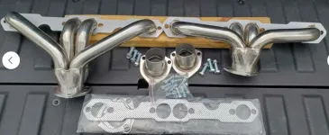

SCORE!!!!! Block hugger headers for small block Chevy, chrome, with gaskets, collectors and hardware for a 100 bucks...brand new unused. Franky's happy
