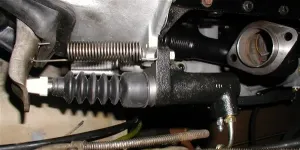

I don't think I have a write up on it. The swap consists of all factory parts, Just later model. My Scrambler tub had the bolt pattern already stamped in. clutch_slave.webp

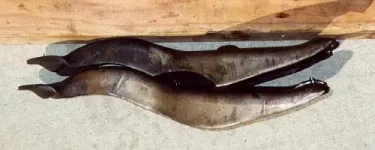

Factory motor mounts suck. Aftermarket mounts are expensive, but never need replacement. I guess it depends how long you plan on keeping your Jeep. jm301z.webp
I coughed up the cash for these bad boy's from M.O.R.E. and I have not been disappointed.:cool:

The problem with factory Jeep mounts, is when they come apart there is no safety. They completely into two pieces!:eek:
