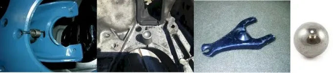

One more thing- I can't find the clutch pedal return spring depicted in the manual. I don't see any holes in the pedal rod to attach one to, either. That seems very relevant to my problem.
On my '86 I did have to drill a hole for that spring and I do not recall noticing a clutch pedal return spring in any of my manuals. It was just an add-on to take any load off the throwout bearing when the clutch is engaged.
That should be in place just to relieve drag on the TO bearing, the pressure plate is responsible for returning the pedal from the release position.
