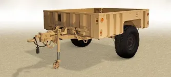

The part I haven’t got tied down is what I will use for a bed. There are several options here. I could use a 1941 to 46 Chevy Truck bed, a 1947 to 64 Willys Truck Bed, a Military trailer, or make the bed from scratch. The first two options are getting hard to find in a decent condition. I could buy new replacement, but that is a little on the expensive side. The military trailer idea is one I like the most. I could buy the trailer, remove the bed, and sell the rest as scrap, getting a return on the money I spent. There are two main types of military trailer beds available. Here are a couple of pictures:
The last picture is the one I’m leaning towards. I like the no fender look (similar to a CJ7 ), and I like the flat top sides of the bed. These would allow me to build a headache rack. All of the bed choices will require cutting them down to fit the Jeep frame. The only military trailer that would not need to be cut is the following:
Only problem with these is they are getting really hard to find or are very expensive.
