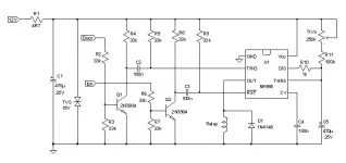

Eventually I'm going to add power locks, and interior lights that are activated by the unlock signal.
The idea would be, unlock the doors via the remote, interior lights come on, on a 2 minute timer, or they would also shut off when you turn the ignition on.
Somebody even drew up a schematic for the particular 555 circuit I'll need. I just haven't gotten around to building it yet.

Here it is. I think the tricky part is having two ways to shut it off. The timer is simple enough, but I want them to shut off when the ignition is turned on like I said. The power lock receiver will provide the pulse to start the timer.
I'll probably use one of those LED strips you see in auto parts stores mounted up on the roll bar, and another one on the hard top shining in the back.
Courtesy of alec_t on Electro-Tech-Online
"I think you can get away with a single 555 timer circuit, as per the attachment.
The 'Door unlock' pulse turns on Q1 to provide, via C2, a brief trigger pulse for the 555 and so energise the relay coil.
The 'Ignition on' voltage resets the timer, via Q2 and C3, thus de-energising the relay.
Repeated actuation of the unlock pulse re-triggers the timer.
Turning off the ignition won't re-trigger the timer; the lights, if on, will stay on until the timed period (adjustable with the trimpot) ends.
Edit: I assumed a relay coil current of ~100mA in the sim. The 555 maximum output current is ~200mA, but it would be better to use an additional driver transistor for the relay if it is current-hungry. Depending on the lights you want to switch you may be able to dispense with the relay and drive the lights directly from the 555."
