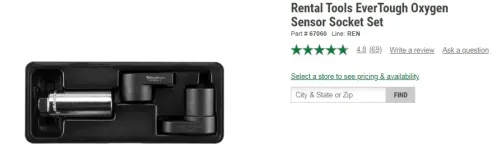

That other bolt/plug, if the correct size hole/threads, looks like it could be used as an alternative spot. May have damaged the original sensor too bad now, but they do make special O2 sensor sockets that are 6-point (unlike many 12-point sockets or wrenches) and they wrap around all 6 points of the sensor (unlike a wrench that hits two flat sides only). Even a vice grip plier would not grab as well. You can purchase O2 sensor sockets at most auto parts stores for cheap, or even use their "borrow a tool" service for free (after a deposit).
Link to O'Reilly O2 Sensor Sockets

I have the smaller black socket, but the bolt isn’t exposed enough to use it very well, just keeps sleeping. I may try and get the chrome one it might work better.

Those O2 sensor sockets have a slot in the side to slip over the wires on the sensor, while still providing a 6-point grip on the sensor's "nut" portion. But since the old one is in a bit deep with part of the "nut" part not exposed, and after stripping it a bit, looks like he needs another solution. I recommend looking at potentially drilling a hole and welding a bung in the exhaust pipe itself rather than mounting the new one in the manifold.

Yes indeed, I replaced 13 of those on my old Ram Charger had to have the tool milled down to get in the flange .
