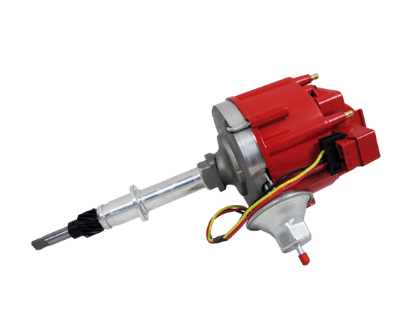

i have an 85 cj i am installing a holly sniper bbd. i want to get a Hei, but there are many options in many price ranges. the truth is i am a tired of spending money and dont want to over spend if i dont need to. jeep will just be road driven. i know there are snobs out there, but is a 500 dollar one ready better than a 160 dollar on? I dont want to over pay because someone spend a few xtra cents and put their name on it -making it worth hundreds more!!
here are a few. I just want to get something that will fit and last and work! I understand i need to be careful of the gears.

This is a long running huge debate. About the best is DUI (Davis Unified) but very expensive. With you having the AMC 258 i6 / 4.2l the distributor gear is not an issue.
Is this your only transportation? I know several people that bought two cheaper ones and keep one in the tool box as a spare.

I just went from all MSD ( distributor / CD box 6AL and coil ) to a HEI / DUI and so far I like it.
I was in the same boat a few years ago. Seemed like $400 was crazy, so I did a bit of looking.
Went with an HEI distributor from Summit. Has not skipped a beat in 3 years now. Quality is great and half the price.
Yeah I was looking at those. Even gave it some serious consideration. Still was cheaper than the MSD items.

I bought a HEI off of Temu and I have not had any problems for a year now and it was under a 100 bucks. I was spectacle at first myself but so far so good and I do a lot of off roading / rock crawling in my CJ7 1982
I went with the Holley Hyperspark and like the setup. Looks better than that huge head on the HEI and integrates perfectly with the Sniper computer controls.
Lots of the HEI's on the market are junk, DUI is the highest rated

so another questions, I orderd the distributor listed above , and still have not installed it yet. mine didnt come with wires so i am trying to figure out what to order thats a good match, and i just notices this is listed as 4.0 and not listed for my year jeep I have a 1985 in line 6 AMC 258 i6 / 4.2l AMC 258 i6 / 4.2l so did i stupidly order the wrong dist? when i am at summit and list my jeep and search this one does not come in. i was not paying attention i guess. please tell me i did not order the wrong one and it will work just fine??? https://www.summitracing.com/parts/SUM-850047/applications
