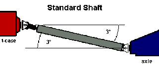

It looks like you need a CV joint at the rear of the TCase. That's too much of an angle and although I cant tell from your picture it looks like the rear diff is almost pointing to the TCase. Check out this link:

Yes, it may help the drive shaft to lower the TCase. You want to keep both U Joints at about the same angle so you may not need shims at the rear axle.
It looks like you may have too much angle at your TCase so you might be better of with a CV joint but then you need your axle pinion gear to point to your TCase.

Your front drive shaft is one inch shorter than mine but don't change yours unless you find out it's not right.
My rear drive shaft is 16.5 inches sitting still. I bought a CV joint to handle the drive shaft angle.
