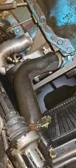

LOOKS Like a OEM hose !!
I would just replace it, and those rusted clamps.
It is starting to "Balloon" at the Water Pump Fitting.
Don't fight getting the old one off, just slice it with a Utility Knife, and peel it off. Saves your knuckles and other body parts.
