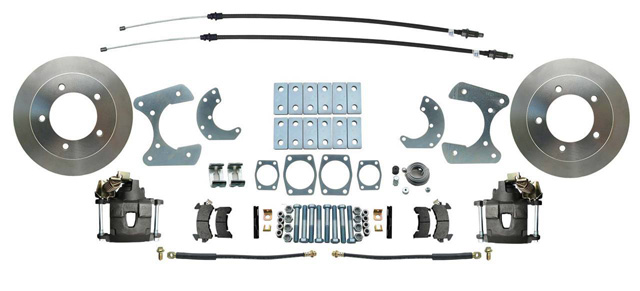

Brakes is another area where it depends on your uses. I have 4-wheel discs and 35" tires on mine and use semi-metallic (middle of the road). Brake pads are made of different materials and fall into three categories: organic, semi-metallic and ceramic. The lining material chosen will impact the length of brake life, the amount of noise heard when the brakes are applied, and how quickly the brakes bring you to a stop. For the front Dana 30 with discs, I use Best Brake #MKD203. If you need new caliper pins (sometimes the recessed allen head gets stripped/warbled out) use Best Brake #H5029. If you still have the AMC20 with the stock drums in the back, Best Brake #GM 151 is for you. These are bonded shoes as opposed to using rivets that can chew a drum if you let them get too low. But if I were rock crawling, I may prefer riveted shoes as the strain on bonded shoes has been known to break them loose. In terms of an upgrade, power brakes and discs in the back. The JeepsterMan has a kit to put discs on the AMC20: TheJeepsterMan In my case, I upgraded to a Dana489 rear end that had discs on it.
