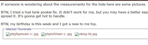

Somewhere on this site is a photo of the measurements needed to make the hole. I posted it at least once.
Measurements for my 79 were different than the 86 BTW.
The photo is missing, I'll look for it. It was in this thread..
This thread has some great pics and measurements: Other thread
