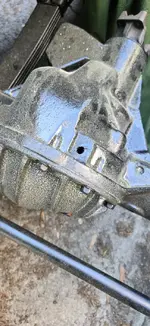

cthomas
North Carolina
79 CJ7, 304
Solution
You're actually missing the "nipples" in the axle tubes where the breather hoses would connect on, not just the hoses, clamps and caps. Those nipples are a press-fit. The hoses are easy, just get the length you want. The caps are readily available and are the same for front and rear. Extreme Terrain, Vintage Jeeps, and others have them. Here's a pic.
If you badly want some original stock parts, there's some on eBay here: eBay link for axle vent tubes with clamps and caps
But for the nipples, I have only seen a few rare cases where someone needed to replace those. Get some threaded hose nipples (Edelmann Part #744250 for example) and use a tap (1/8" NPT) to thread the holes in the axle tubes and screw the nipples...
Solution
The factory AMC20 breather is a plastic snap in breather that is just about impossible to find. Most people just use a NPT tap and put in a generic one. The stock 20 breather uses these weird spread tangs that lock into the tube. If you do tap it you then have the great option of using a barb fitting with a hose to enable deeper water foraging.
