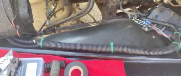

fusebox, airbox, washer jug, charcoal canister. Next tidy up and finish wiring on driver side.
Also, this is an OEM AMC washer jug in case anyone needs the part number
Due to space constraint with CJ fenders, I can't use the OEM antifreeze overflow, so, custom overflow bottle.

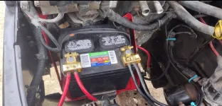

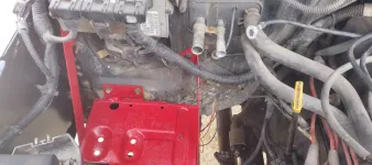

Battery tray mounted, starter changed, doing bat cables today, maybe looking at running by end of weekend. bought new front bumper to mount winch etc. going to be hot next week, will get hood finished and painted

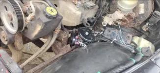

Horns installed and wired, don't forget grounds, add extra, bat cables hooked up, headlights working, even started it up briefly.

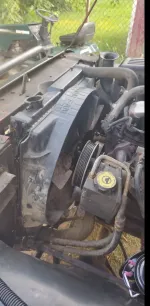

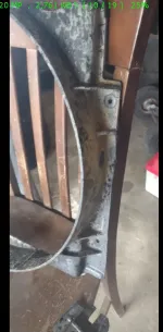

New alt wire installed, completed exhaust, had to replace the manifold pipe to manifold bracket with aftermarket, old one was so rusted couldn't even tighten the pipe, added a hanger and another tailpipe clamp, while i was under there, saw a heat shield rattle from a rusted out section, replaced hardware with fender washer to tighten again. Started to mock up radiator and shroud.

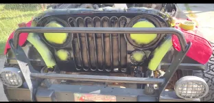

I personally like it better without the scoop. Those weren't really a CJ option
So far, before and after pics. still have to permanently mount the hood, rad overflow, washer nozzles, paint the hood, replace muffler, some interior switches wiring, wire up winch, go over brakes from sitting, fender flares.
Like the new, over the old bumper.

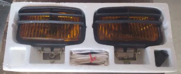

NOS 1980's never opened still in sealed plastic fog lights

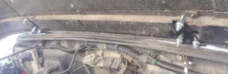

custom hood braces for CJ hood using oem TJ hinges
