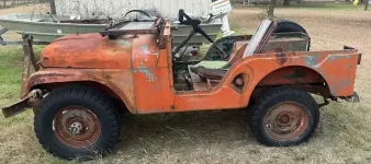

Looks like a great project. We are here to help and back you up all the way to the end! :chug:
Looks like a GREAT "As Found"
Project. The body looks usable from the pictures you posted.
*Yes Drain the oil, and filter canister.
*Yes spray Penetrate into the cylinders.
*And for the short duration of a Compression Test, you don't need to refill the oil at this time.
*Get some baseline numbers on compression. If nothing is really bad, with a engine that has sat a long time, those numbers will get better as everything reseats once you get it running.
*Then refill with Fresh Oil, and replace the Oil Filter. (Note, prefill the Oil Filter Casing to presoak Dry Filter, do Filter first as the Oil will drain down some into the crank case so you don't over fill)
*For the Distributor, just do Points, Condenser, Rotor, and Cap, Spark Plugs, for a initial start. Maybe a set of Wires too.
It is a Rarity to need to do Shaft Bushings, or Mechanical Advance work other than Lubrication.
*Check, there might be a "Oiler" down on the Side of the Distributor. Flip up the tiny cover add a Little, and I mean Little oil here. No need in oiling up the entire inside including the points.
Good Luck with your New Family Member.....a 1956 JEEP.
Just an Idea. Do you have a "Strap Wrench" or a "Large Oil Filter Band" Wrench?
Remove the Fan Belt, slip the Strap/Band wrench over the Engine Pulley. Now see if it Turns Over.
Also have one of your Junior Assistants step the Clutch Pedal Down if you still think the Transmission is Engaged.
