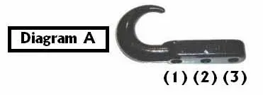

The hooks you purchased will work just fine. Mounting them on the bumper mount location, in my opinion is not a good idea. I would recommend installing them on the crossmember, close to the frame welds, making sure none of those welds are cracked. Also before you start drilling, pick a location that can be accessed from underneath clear of the steering box mounts.
CJ's never came with tow hooks. So anything is a custom mount.
Csuenger is correct, but the earlier Jeep Grand Cherokees did, and they were made from forged steel, not like the cheap aftermarket ones that were made from pot metal. Both were rated at 10,000 lbs on a straight on pull, but on a side pull, the aftermarket ones can bend over.
From what I've seen from the aftermarket hooks, the 3 hole ones work on 87-95 YJ Wranglers, and the 2 hole ones will bolt onto later CJ (and TJ's, too).
