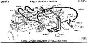

Was wondering if there is a basic vaccum hose lay out(no-emissions) for the 78 jc5 Inline 6 i believe its a AMC 258 i6 / 4.2l . All the hoses were gone when i got it so starting fresh:cool:

hey I did some digging and found out the motor im working with is a 232 not a 258 any differences or problems i should know about?
No difference at all hose routing, the only difference between the AMC 232 i6 and AMC 258 i6 / 4.2l is a slightly longer stroke and a larger bore. Otherwise it's basically the exact same engine.
