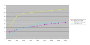

Saw your other post about timing but thought I'd throw this in here. This is the timing/advance curve plot I did on my engine. I think it was before tweaking but can't remember. I thought maybe some of the readings/numbers might help?
The yellow is my timing with the ported vacuum and centrifugal combined. The pink is the timing with the vacuum disconnected and centrifugal only. The light blue is the vacuum pressure reading vs rpm.
That does help, even with the ported vacuum it still reads at idle and looks like your at about 12in of vacuum by 800rpm. I'll compare mine to this tonight. Thanks!
At ~600 rpm I'm reading 10in vacuum and 15in by 800 rpm. We have company over so that's as far as I got.
