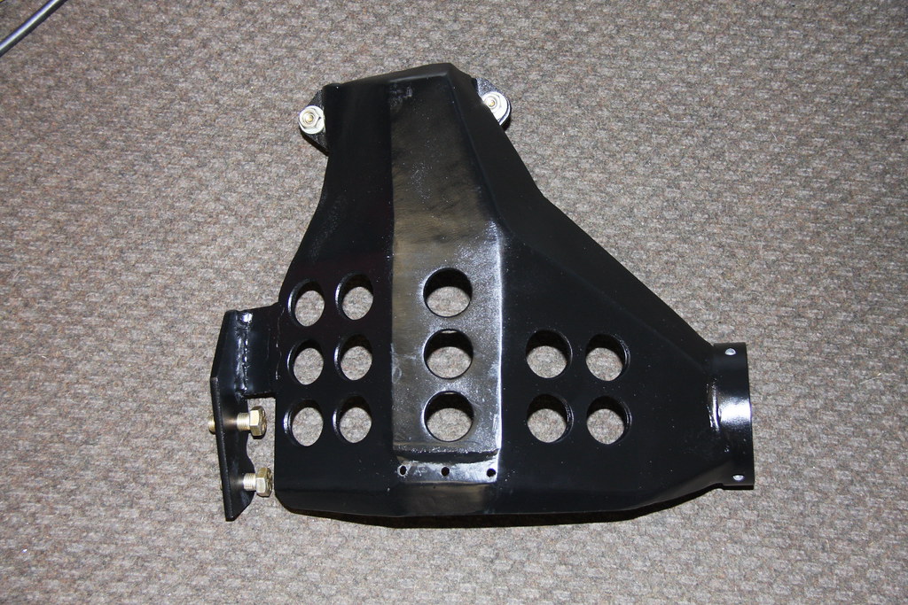

The aluminum skid plates for the exhaust and Transfer Case /Transmission . The latter is due for further modifications at the present time as the D18 emergency brake it protected no longer exists.

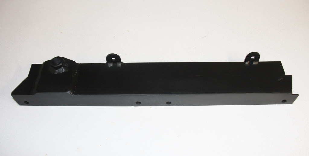

Cross member insert. It also serves as the fuel tank skid front mount. The tabs mount the tank breather line from the right side.
