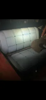

Ok so, I’m sitting here with my father in law having some wobble pops, and I’m learning some more about the Jeep. Apparently it used to have Renegade decals on it. Now on top of that, my father in laws 78 CJ7 is in my yard right now as they are moving. The back seat in that jeep is the one out of my wife’s jeep. Things get cloudy with details, but everyone is 100% certain that this back seat is the one from the 79 CJ5 . Someone tell me I’m crazy, but is this a Levi (Edition) ’s seat? Could this have been a Levi (Edition) ’s? I swore it is a base model, maybe it’s something more? Any insight from anyone?

Ahhhh ok. No worries at all. I may have rambled a bit as I was indulging, was hoping I didn’t break a rule or something. If you can’t find them, it’s no big deal. It was mainly about the seats being Levi (Edition) -esc and that the Jeep is almost certainly a Renegade . Or at least used to have the renegade decals. Thank you so much for all your work here, you sir are awesome 🫡
Ahhhh ok. No worries at all. I may have rambled a bit as I was indulging, was hoping I didn’t break a rule or something. If you can’t find them, it’s no big deal. It was mainly about the seats being Levi-esc and that the Jeep is almost certainly a renegade. Or at least used to have the renegade decals. Thank you so much for all your work here, you sir are awesome 🫡
