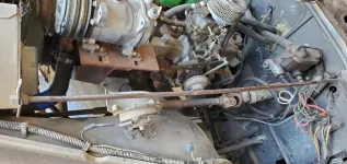

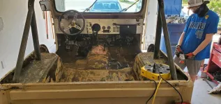

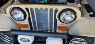

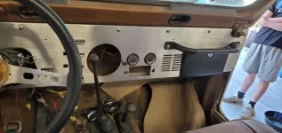

Hello all! I just traded a restored 1989 EZGO 36V Marathon for a 1977 CJ5 . I am looking forward to working on this CJ. I have always wanted a CJ (I owned 2 JK prior). I work as an Aircraft Mechanic so I have the mechanical know how. Looking forward to showing you all how Jeep ignorant I am. Here are some pictures from the first few days we brought it home.
You have your work cut out for ya but looks like you enjoy it.
Love the dash!! Is that an air conditioner compressor?

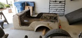

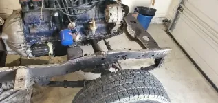

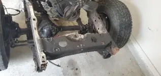

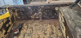

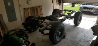

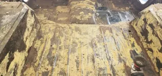

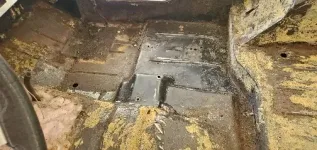

Ya, I am in it to win it now. I have it torn apart to a rolling chassis. I will take it down to frame next week. I am sandblasting the frame and repairing what needs to be fixed. There is a chance it will be cheaper to get a donor/replacement frame. We will see. There was 42 years worth of "engineering" done to this beast so I am going deep. Wife has that " how much $$$ ??" Look already. Here are some more pics. Tub has some rust issues on rear floor panel and passenger inner wheel well. Both floor pans have repairs needed. Fun fun fun. Foumd the paint code 7y- Tawny Orange. 8c0cef9b42a9ea8e4737ae7b675f6444.webp bb163c7c5960571ebe4ca65569fee5b3.webp 0f1f5d330a34858dd0f2e99c3ef93ae3.webp 23fa52eb5947a89e737b1ca8850a2f36.webp 0b22bd9e4980e9b9f8a486de2391992f.webp 1c855289c5ca00314b2bba4ecb0b6b54.webp

The rear crossmember was a bolted in piece that PO installed. I didnt notice that until we started to take the vehicle apart. I think, structurally, it will be fine.
