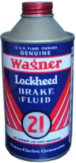

Then you should clean everything and put them together.It's better to put your brake fluid in it on the ground and push the primary piston until the fluid comes out completely from the holes. after all it's time to install it :drool:! don't damage vacuum hoses!!
