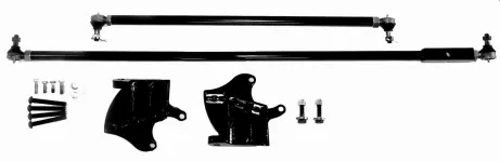

As for correcting the Drag Link issue, I’d stay away from the S shaped ones. Either look at a flat top knuckle for the passenger side with a higher crossover setup for the drag link. Or, both sides new flat top knuckles with full high steer set up with the tie rod and drag link both up high. Or, maybe an inverted T setup.
Look here for some examples…
