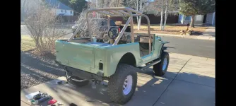

I wanted to start documenting my '81 AMC CJ7 project. My main plan is to keep the Jeep operational during most of the work. I purchased the Jeep on 10/19/22, so haven't had it long. I've always wanted a CJ, and never owned one, despite owning a YJ, couple of TJ's, a JKUR and a JeepSpeed XJ. So, this is my first CJ, and happens to be the same age as me.
Here it is the day that I dragged it home:
Sure, it's a little ugly, but has some kinda cool armor for the front fenders, a good front bumper, rock sliders, extended roll cage tied into the frame, ARB air lockers, an on board ARB air compressor, 33" BFG mud terrains, and a pretty cool roof rack!
It has a AMC 258 i6 / 4.2l "/AMC 258 i6 / 4.2l engine, 4 speed manual Transmission and a Dana 300 Transfer Case . The engine was recently rebuilt, along with a new alternator and all new ignition bits.
As far as axles are concerned, it's a narrow track width, with Dana 30 front and AMC20 axles, each equipped with ARB air lockers and 4.56 gears. The AMC20 has some aftermarket one-piece axle shafts in it.
First things first, I cleaned the idle circuit of the carb, since it wouldn't idle. Topped it off with fresh gas and replaced the fuel filter. Then took it out for its first trip into the woods!
As Captain Ron says "if anything's gonna happen, it's gonna happen out there"!20221025_154718.jpg20221026_164141.jpg
