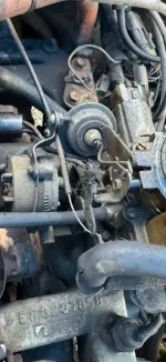

New to me 85 CJ7 AMC 258 i6 / 4.2l I6. Don't know much about the history. Seems like everything on it has been modified or messed with in some fashion. Couldn't get it to idle without having the choke all the way out, even then it was rough. After looking at it I realized most of the vacuum lines had been abandoned but all of the emissions and air breather pieces are still there. I've replaced the fuel lines, fuel filter and necessary vacuum lines. I'm concerned that the electrical system is shot or not operating correctly since none of the sensors were connected. Should I bypass it altogether? Am I better off ordering an older style fully mechanical carb or should I order a rebuild kit for the Carter that's on there? My goal is to get it running well enough to idle so I can move it around the yard and diagnose any other potential issues.

I should have also noted the following:
-Fuel was coming out of the carb when the engine was running
-Fuel pump has not been replaced. fuel lines going to the rear have been replaced.
-Gas is possible bad, haven't had a chance to syphon. Can't tell how much is in there due to faulty gas gauge.
If fuel is being pushed into the carb while running that means the float valve is old and leaking. It (the carb) definitely needs to be rebuilt. The good thing it is pretty easy.
That's what I would do first. Most likely will fix the majority of your issues.
Also, you cannot make any tests with bad gas. Just take a gallon or two portable tank with an electric pump and bypass all your bad stuff.

I already have a carb rebuild kit so I can work on that. Is there somewhere I can find a step by step to using the electric pump and where to bypass? Unfortunately, I don't have much experience working on mechanical engines but I'm willing and eager to learn.
