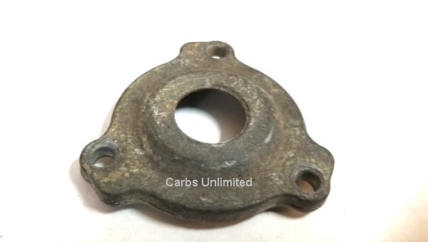

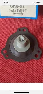

The only part I know for sure is missing is the choke pull off cover. It’s on the top of the carb to the rear of the butterfly. And I get a little seepage around the throttle shafts. I assume that will cause vacuum issues, but it generally starts right up in warmer weather and seems to run well, but rich. I think that’s the choke issue. The thing in the pic sticks up through it. I started it this weekend mid 30s and it ran rough for a while. Again, choke issue.
I get a single pop when I turn it off sometimes through the exhaust. It might be timing, or air through a muffler hole igniting fuel, but I bet it’s that choke making it run rich.
