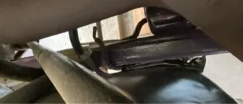

The fuel line coming out of the fuel pump is metal and it bends 180 degrees and goes RIGHT UP between the fuel pump and the engine block literally less than 1/2 an inch from the block. Once it gets to the top, it bends again, goes about 6 more inches then turns into a rubber fuel line which goes to the filter then to the carb.

I had the same issue with my 1972 CJ5 . I installed a two outlet fuel filter and ran a return line back to the tank. Problem solved for me, if you choose to do this, the smaller filter outlet hole is on the top, connect to the tank return line.
I had the same issue with my 1972 CJ5. I installed a two outlet fuel filter and ran a return line back to the tank. Problem solved for me, if you choose to do this, the smaller filter outlet hole is on the top, connect to the tank return line.
I’m unsure where a return line might be but I will look into this. Thanks!
I physically ran a return line to the tank with steel brake line. There should be an unused port or two on top of the gas tank you can tie into. Doing that way is probably not recommended by todays standards as far as rollover shutoff, etc. We die like real men! No airbags either!
