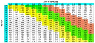

i have a 58 CJ5 that i would like to get a little more top speed out of. it has 5:38 gears now. what would be a good gear ratio? i don't want to lose the low end power but would like around 10 more mph on the road

Also there's charts showing rpm ranges here:

I would guess that using the ratio chart to get about a 300- 500 rpm drop at 55mph would give you more top end. The low range of the tcase will make up most of the offroad low end.
