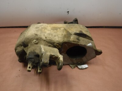

1980 Scout Dana 300s are the year you need because they bolt right up to the T-18. Otherwise, it's more work with adaptation. We used to have a few of these, but I think they're all gone now.
Here's one on Ebay...

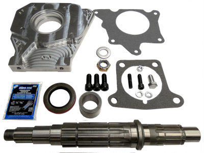

But, the Dana 20 Transfer Case will take adaptation to work with the Ford T-18 . This means a new output shaft in the Transmission and the new plate.
You’ll need one of these for about $600…
While you’re inside the T-18, you might see other items to address, like shifter parts or maybe a bearing or two will need replacing. This might be another $100 or so.

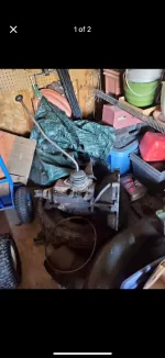

I've had a Ford T-18 languishing on my workbench since I parted with what was supposed to be a life long career. Since then I've discovered I had Osteoarthritis and as the T-150 is running fine the T-18 project will likely continue to be last on my list. This T-18 shifts smooth and the gears show very little wear it's just that these T-18's are so damn heavy.
It’s relatively easy to build an electrolysis tank to help loosen a lot of that rust. I’m rebuilding a T150 right now and have cleaned the case down to the bare metal with one.
Very cool. I'll look into it. I'm sure the Transfer Case is the same.
