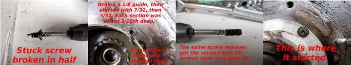

Breaking down a Dana 300 Transfer Case on the bench, I got all six flat-head tapered screws of the input shaft cover started out with minor force needed. One of them, at about 1 O'Clock in the attached photo, seemed to hang at about 1/8 inch extraction. I put some good machine oil into the threads and worked it back in to release the binding.
Now it has decided it likes it there and won't extract! The extractor hole seems very soft steel and is burring, rounding.

Can someone who has dealt with this before give me some good advice on how to go ahead? The very last thing I need to do is booger up the screw hole threads or damage the seat!

Re: Dana 300 adapter plate - screw removed
I didn't really expect someone to offer me a Silver Bullet like the Lone Ranger.
I went ahead and drilled a guide hole maybe 1/8 inch dia. and about 2/3 of an inch deep. I came back with a progression of drill bits, large to smaller, going about 3/16 deep each bit rotation. When I thought it was good enough, the screw remover, about 1-1/4 inch long and tapered, bottomed out so I went back with a bit more 1/8th dia.
The screw broke in half on the first extraction attempt. I doctored up the tapered hole a bit and with about equal caution and force, got the second half to come out.
The threaded hole goes completely through the case. Likely there was gummed gunk holding the back side of the screw. I'll replace these with shorter and harder screws, hex-sockets like the book says.
Here's a picture for you when it is your turn, and if you work on Jeeps, everyone gets a chance to try this!
