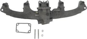

What are the little allen bolts for on each of the exhaust ports?
I'm guessing you remove them for some type of sensor?
That's where the factory emissions stuff goes.
