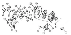

To correctly adjust the clutch - there is a gap that you should measure when you depress the clutch pedal. You take off the access cover, press the pedal and then use shim or a feeler gauge to set the gap. Then make sure the throw out bearing is not engaging the pressure plate whil in the disengaged position.
That is the 'correct' way to do it - the way that I and most likely 99.999% of others do is just by feel. You want the clutch to release all the way but you only want to have push the pedal as far as needed to get there... I hate clutches that you have to push all the way to the floor to get it to disengage... :)
Always check and make sure the trow out bearing is NOT making contact with the pressure plate every time you adjust the clutch. If it is - it will wear out the bearing prematurely!

My clutch uses a mechanical link - does yours have a cable? If it does - the cable could be binding also causing a problem.
The is a sound scientific way of checking the gap between the throwout bearing and the pressure plate...
Grab hold of the throw out arm and wiggle it... If you can move it a little there is a gap! :) You should be able to move it for and aft just a hair! :)
honestly.. im not sure what my jeep has.. it is such an old vehicle, and is so new to me.. you never know what kind of parts have been replaced, tampered, or rigged.... it looks like the brake and the clutch are on the same arm.. which doesnt seem correct...
I would still disconnect it from the throwout arm and be sure is slides easily.

Are you positive about that? You mean the cable is wrapped around a bell crank or some thing? Can you take a picture? I'm not real familiar with earlier model CJ's... :)
im not sure what exactly the bell crank is.. but i took pics.. and im waiting for my phone to upload them( sorry thats the only camera i have right now. haha i miss placed my cable to my real camera.)
*edit* i found what the bell crank is, and no its not wrapped around that in any way... pics coming your way soon!
Kinda hard for me to tell exactly what type of cable you have but it sure looks like it is in a sheath to me. I just want to make sure the cable is not binding before you tear into the clutch...
