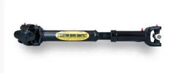

Tom Woods is highly recommended and they have great information on setting up your angles.

Considering cost - Happen to be pricing out a new front driveshaft this week for my early Bronco project. Looking for same as Woods picture above with dbl cardan on one end and full length slip.
Solicited several places, even local shop, and Woods was the cheapest by $50 or so. The free shipping helps.
