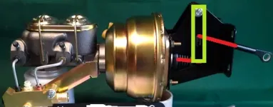

I currently have manual brakes and I have a booster, bracket and master from another Jeep but the booster and master cylinder are both shot. I like the dual diaphragm booster and I plan to install a master cylinder with a plastic reservoir with a cap as well.
A couple of questions: did you already have power brakes or did you convert from manual? Second, if you converted, did you have to make any changes to the brake pedal pin location that connects to the booster or was it just a plug and play?
Thanks for the very detailed reply. I actually have the OEM bracket but it seems I might need to modify it to fit the booster that you mentioned in your post. When I asked about modifying the brake pedal I think I got it confused with the modifications needed to install a hydraulic clutch over the original mechanical. Your explanation of the bracket is spot on, since mine is all in pieces it will help putting it back together.
Mine is running a YJ bracket and booster with the pushrod shortened so a CJ master can be used. I didn't do it the previous owner did it to clear the TBI air cleaner on a AMC 258 i6 / 4.2l .
