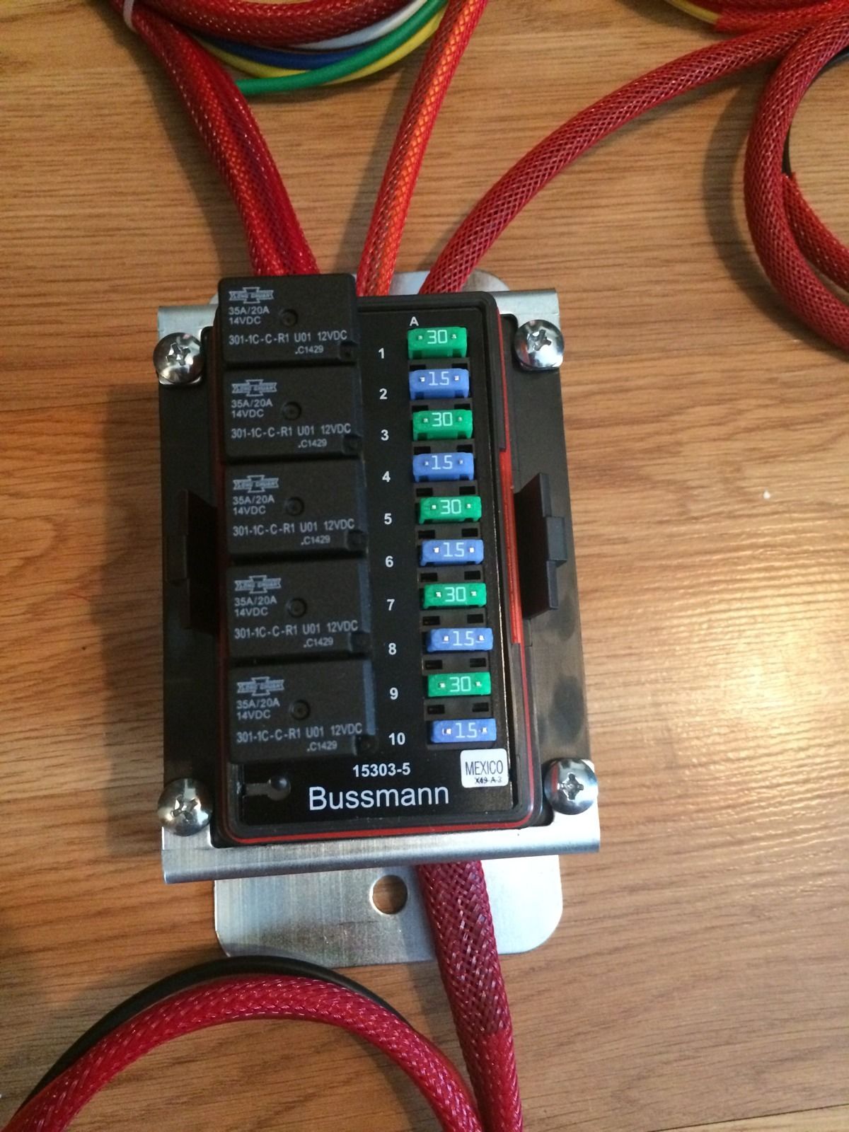

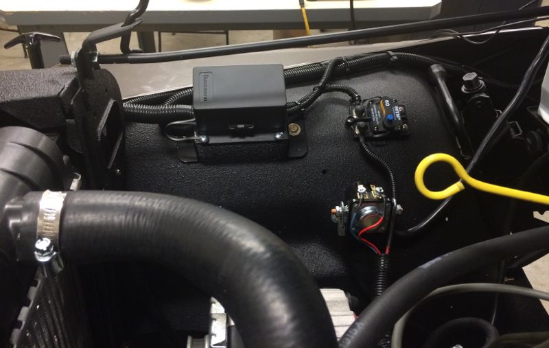

I upgraded my electrical so that I could add H4 style headlights with new glass housings (Hella). I don't like the LED look either; although Holley has some traditional looking LEDs that look great (pricey at $200 each).
It involved adding a Cooper Bussmann relay box which provided a 30 amp relay to high beams and a separate 30 amp relay to the low beams. This removed the load from the existing fuse box and provided for additional components (five 30 amp relays and five 15 amp circuits. All this protected by a 60 amp circuit breaker shown on the wheel well.
