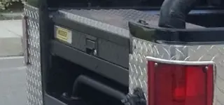

Finished the my rear trunk mod off. Looks a little more finished now. Nothing will roll out the back either. Sorry the pic sucks. The first one is before the painted screen was added.

Locking toolbox
