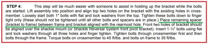

The M.O.R.E. bracket actually includes a 1/4" spacer and includes using it in the instructions.

Sorry my question wasn't about the spacer behind the shackle mount - that is critical and must be run. My question is about the holes in the crossmember. As you can see my bracket does not reach the holes in the crossmember. I've determined that it must be the bracket as sold to me - I will cut spacer to fit between the crossmember and the steering bracket but its a real shame I bought a junk china product for my Jeep. I should have returned this the second I saw the cosmoline.

Yea the MORE fits flush. You do also drill a new hole on top. No biggie. I try to only buy quality as much as possible. Once in a while you just can’t.

2 or 3 bolts at the top at the cross member ? The MORE has 3 in a triangular pattern. 9A3704A6-1BAE-4C83-8488-AF7BFCB561E0.webp
I have a shop and cut a spacer the size of the whole section that presses against crossmember. 3 little spacers wouldnt have much contact. And yes 3 bolts through crossmember like MORE.
