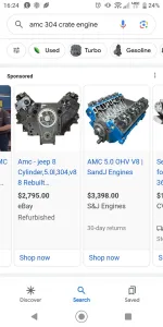

I'd say best option is a rebuild of your current engine. The price quote for 5k for a long block seems steep to me. I had my AMC 258 i6 / 4.2l completely rebuilt with all new parts for 3,100 and an LS 1 done for 4,200 at my local machine shop. Even with paying for removal and installation I don't see where 13k is coming from. I'd contact a few machine shops in your area and see what they say about removal rebuild and install. Bet it's cheaper than 13k
Not to mention a quick search on Google and a AMC 304 is half what they quoted.

I’m not sure why they have $5K for the long block, I’ll have to get them to clarify that. Could be an over guesstimate. Unfortunately I keep hearing from various mechanics that there aren’t really any good options for machine shops in the area or any that have done CJs. They’ve recommended sourcing the engine rebuild through S&J Engines that would come with 7yr/100k mile warranty. I think the website has the long block at $2700 + $600 core(refundable) plus shipping.

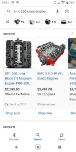

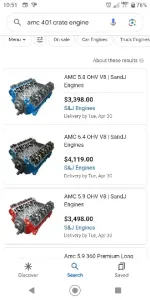

A 360/401 is pretty much a direct drop in with no major changes required. machine work would cost the same rather it's a AMC 304 360 or 401 price for a done version isn't much more than that of a AMC 304 e3a8d6ab030b28c2c31281ce5591580c.webp 711e3a371b34cc4d1e1764b5f65693d0.webp

A 360/401 is pretty much a direct drop in with no major changes required. machine work would cost the same rather it's a 304 360 or 401 price for a done version isn't much more than that of a 304 e3a8d6ab030b28c2c31281ce5591580c.webp 711e3a371b34cc4d1e1764b5f65693d0.webp
