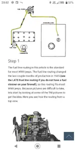

What about the fuel system? Is this a cam-driven fuel pump? How likely is it that I can get away with some sea foam and new gas? Is there such a thing as a temporary 1 gal plastic tank or something?
