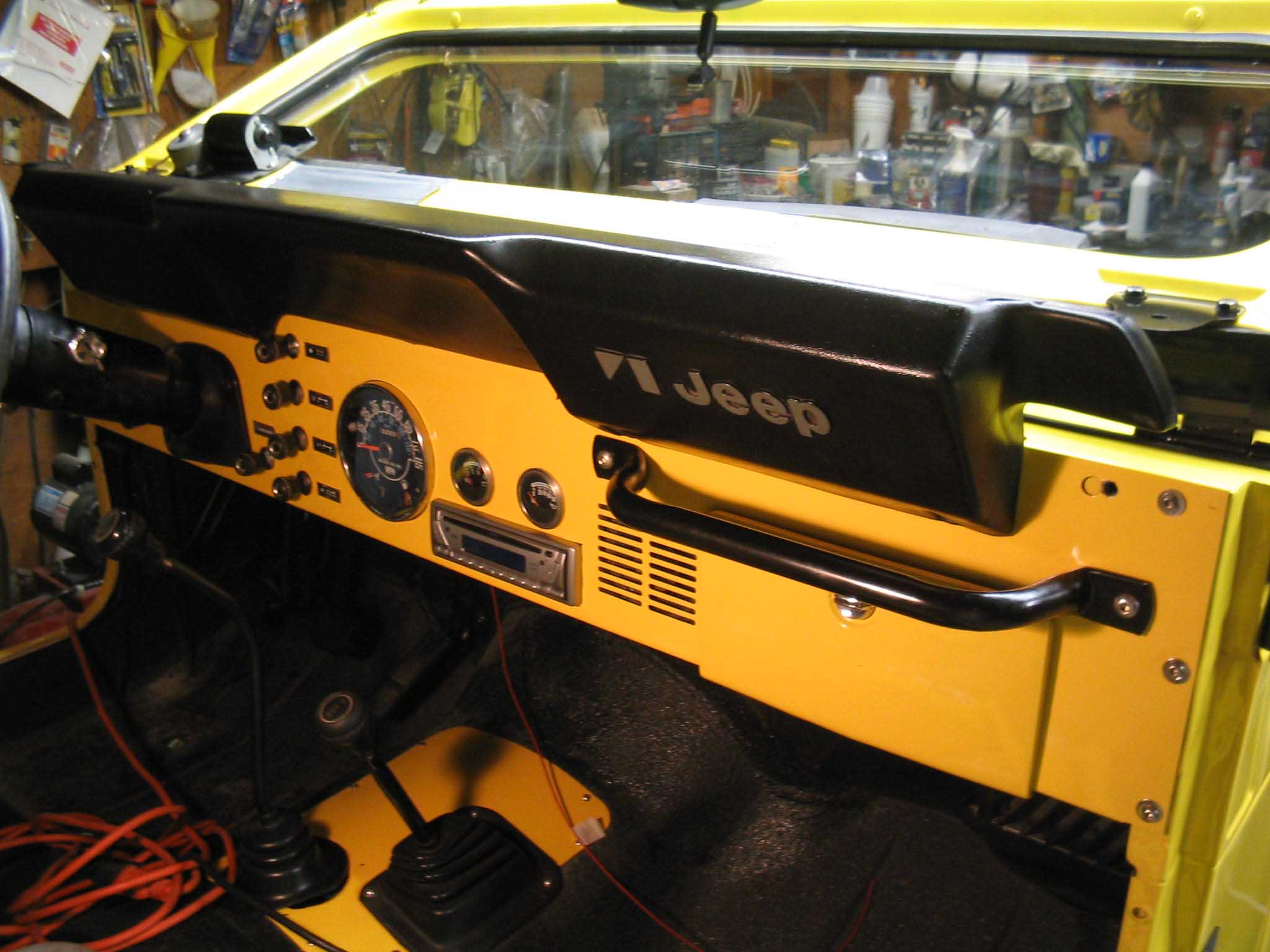

The first pic is just kinda how the dash is gonna look.

The next is starting to look like the end product. You can see the old dash in the background. Anyone wanna buy it? I'll make a helluva a deal. Anyway, I had bought another dash, had it painted then today just marked and transferred each piece. So now I got an extra.
