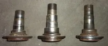

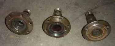

OK Let's talk about the spindles
  • 3 spindles in the picture are Dana 30 , Dana 44 Waggy (78) & a Chevy small bearing spindle
  • All have a 6 hole 4" bolt circle
  • All have a 3.375" pilot stub that mates to the knuckle
  • I used the Chevy small spindle with A10 wheel bearing sets
  • And the 1978 Waggy Dana 44
  • 3 spindles in the picture are D30, D44 Waggy (78) & a Chevy small bearing spindle
  • And the 1978 Waggy D44
